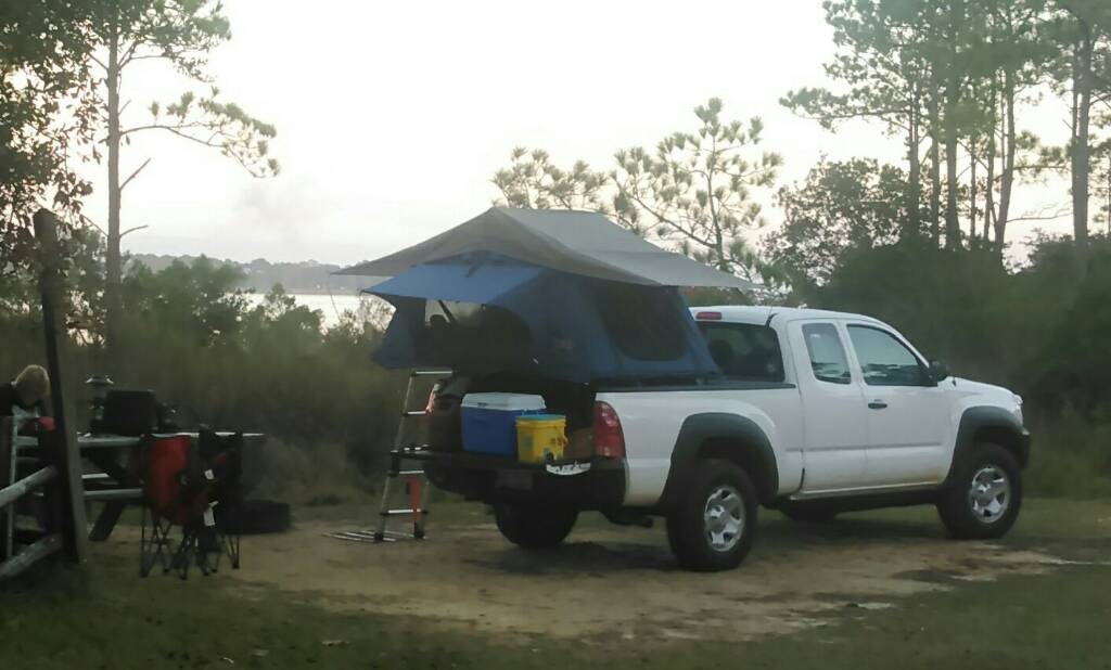

Bed rail bars for the RTT. Purchased from 4x Innovations. Very heavy duty product. Holds the tent and my wife and I with ease. Heavy in weight but strong.
RTT-Tepui. Smallest tent made by them. So far (1 trip) it worked like a charm for camping.
