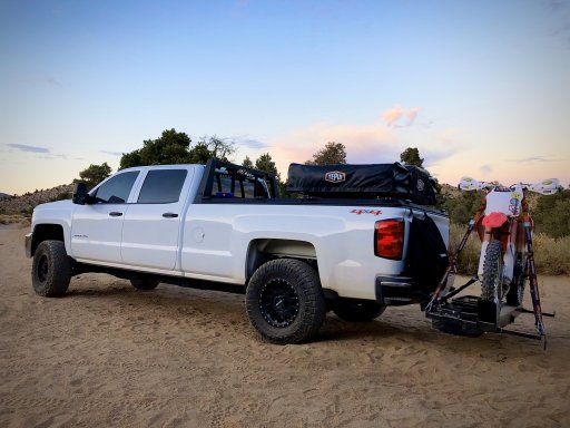

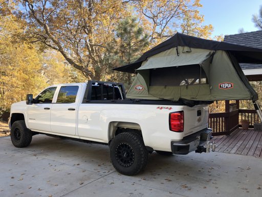

Hoping to inspire more guys to get into full sized rigs and see the many benefits they can offer. Stay tuned for updates and to see her in action [emoji41] God bless!IMG_3778.JPGIMG_9114.JPGAdjustments.JPG
