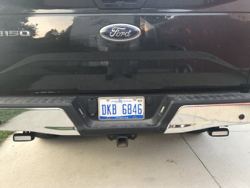

I installed Rigid LED lighting, they are top notch and a brand that I can trust. I used their custom bracket to replace the stock fogs with one pair spots and one pair dispersed each pair on their own circuit. I mounted 2x2 scene lights in the front stake pockets and are individually controlled. The rear lights are SRQ2 dispersed. This is an awesome combo. I added smoke covers to the scene lights so they better blend with the truck.

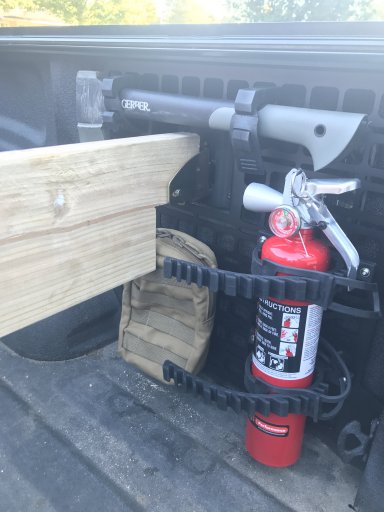

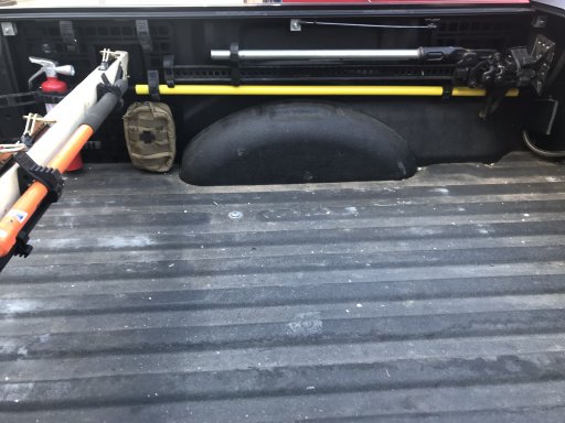

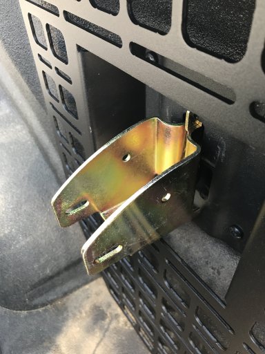

I just installed BuiltRight's truck bed system, it's not too bad, I've only populated one of the four panels using quick grips with stainless hardware. I also am testing some homemade cargo bars using untreated 2x8 lumber, quick grips, and some e track brackets/mounts to add modularity to the bed. ill tweak the design and perhaps have a welded up steel or aluminum version eventually. The front section has the perfect space for Jerry cans of gas and water in addition to my solar panels, tripod, or bag chairs, the middle section for cooler, chuck box, etc, and the rear my aluboxes.
One alubox holds my SAR sustainment pack, boots, shirt, paints, and socks and during trips will be clothing. The second holds my tools and recovery gear/bottle jack/jack stand/ratchets straps/etc. instead of a winch I use the larger capacity more power puller with synthetic line.

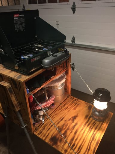

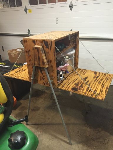

I made this checkbox when I was 16 and it has been awesome however it doesn't fit under the bed cover so this winter I will be designing something a bit different.

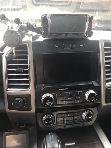

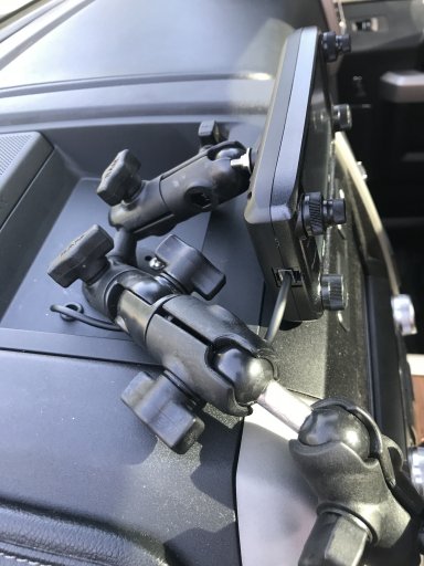

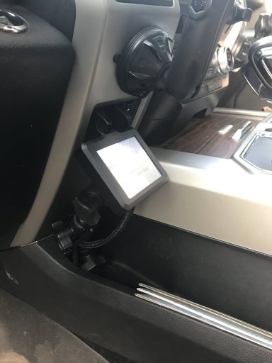

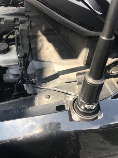

Today I installed most of my ICOM ID5100A and antenna. I hard mounted a double ball ram mount in the tray of the upper center stack. One ball to hold the HAM faceplate, the other my cell phone so I can eliminate the suction mounts. I routed the control cable down the stack through a grommet so it looks clean.
On the radio I changed the stock plug to an Anderson power pole for easy swap out. I will eventually pick up a DC power supply and mount an antenna on my home so I can use this as a base station. In my truck the radio will go in the main compartment of my center console.
I have a Comet antenna on a stainless NMO mount and I RTV sealed the cable for extra protection.
The power wire is 10 gauge with a fused Anderson power pole plug running to my SPOD. I could have went right to the battery but I like the circuit protection and battery run down capabilities the SPOD gives and I shouldn't get any additional radio noise.
Tomorrow I'm letting a pro finish the install so I don't destroy my center console, the hand mic will set in a tray by my right leg next to the hard mounted 20w Icom speaker. I'm excited to see how much better this does than my handheld, it will surely be easier to use on the road.

May I ask where you got the anchors you used to mount the boards to the bed interface plates? I could sure use a set of those.

Mounted my external speaker and RAM mounts double ball to hold my cell phone and HAM head unit. No more suction cups!
I made a different divider as the 2x10 was just too big and wouldn’t allow my shiftpod to pass under it. I added a full length shovel, rogue tools fire hoe, and my high lift jack. The IFAK will get filled shortly, the other pouch may hold air tools.
The Aluboxes hold my recovery gear and my SAR gear.

Love the camp kitchen box. We made something similar to this in my Boy Scout Troop years ago.

I dig it! And the Coleman stove and lantern. I have an old duel fuel from 1971 and a milspec 252 lantern from 1963. The stove works great! The lantern is in pieces getting rebuilt.
That’s awesome! I am all for tech and new gadgets but this lantern and stove works every single time with close to zero maintenance. Show that lantern off when it’s rebuilt!
I believe my stove is the 242E. Works like a charm. Managed to snag another lantern for dirt cheap. It's a 220F from '66!

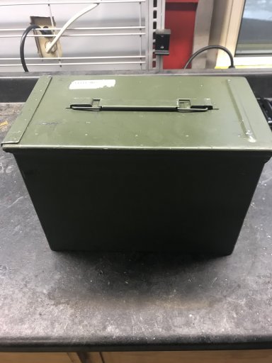

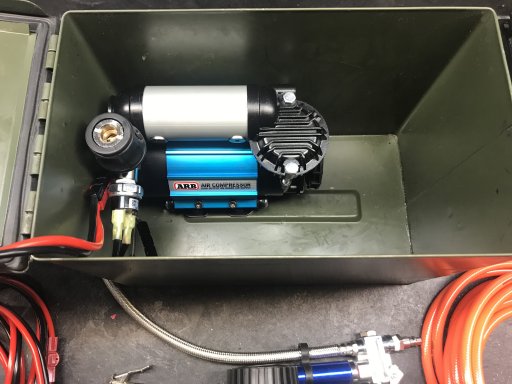

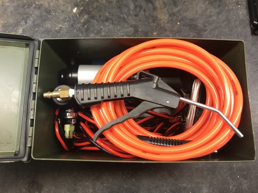

IMG_9814.jpg IMG_9819.jpg IMG_9818.jpg IMG_9817.jpg I put together an on board air set up. I used a fat .50 ammo can that I cleaned the stencil off with acetone, and ARB compressor, compressor kit, 10 gauge wire, alligator clips, and Anderson power pole connectors.
I don't have room under my hood and I don't want to mount it in the cab or bed. This set up allows me to connect to any 12 volt battery with the 12' extension cable I made. I can easily change ends with the Anderson power pole connectors at each end. I didn't need to use any of the ARB wiring harness. I bolted the compressor to the bottom of the can using two carriage bolts in the recessed area of the bottom of the can so it's not wobbly. The pressure switch cuts off the compressor at 120 psi so it's not constantly running. Simple and effective.
