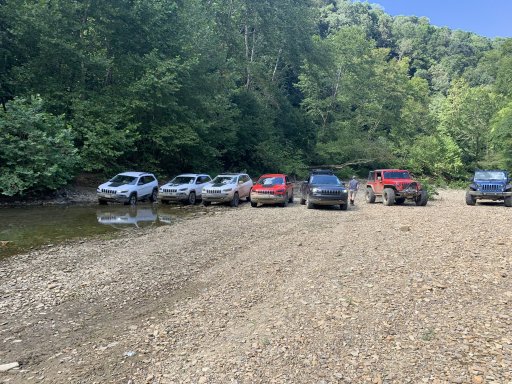

I've watch almost everyone of the Fearless Trailhawk videos. Watching you all take them through what you do is one of the reasons I went with my 2016 KL. I'd love to come ride with you guys sometimes.Here’s some pictures from our Quarantine trail ride!
View attachment 150875View attachment 150877View attachment 150878

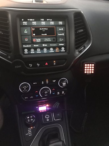

OK, this mod is NOT for everyone but some might have use for it. Over the years, I‘ve gotten used to having red map lights in my work vehicle and so now I change my personal vehicles to red as well to preserve my night vision. The 2019 Trailhawk has 2 different (incandescent and LED) intereior lights so you have to get creative.
The front map lights and rear cargo lights are pretty straightforward. You pull the snap tabs for the console down from the front (closest to the windshield) and then simply replace the bulbs with LEDs. Don‘t believe the web, 194 bulbs are correct for the 19. Same size for the two cargo lights.
For the two small LED map lights above the passenger seats, I discovered that they are single LEDs soldered onto the circuit board. So I just ordered some red adhesive tint and cut it to cover the lenses. Two layers matched my other LEDs perfectly.
I left the white lights in the visor vanities for some white light if needed and the Cherokee has a small white LED shining down on the center console that can be turned off from the controls on the left side. So now I get to keep my night vision and still have white light if I were to want it.
