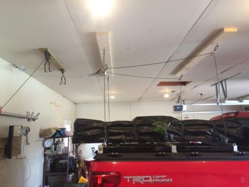

My wife says I have a tent fetish, but I really got a kick out of setting this up. I mounted the tent to the rails that I use for the truck cover extension, and then built this (Ignore the black bike hooks):
A quick $100 at Princess auto for a hand winch, rope pulley, eye bolts, carabiners, some rope, and some creative configuring and voila. Roof top tent lift.

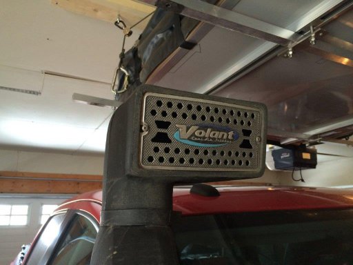

Heh Heh. Clifford got some more minor additions... ARB air locker installed, and functional. Volant Snorkel in and ready to go for a swim!
4 Wheel Auto did the heavy lifting for me. Thank goodness. What they expected to be a 2 day job turned into a 4.5 day ordeal. I think I have some tweaking to do on the finishing touches but they did a good job.
ARB HO compressor on board for airing up & down as well.
Switches on the dash in the blank locations
First thing I did was melt an air hose. After they carefully ran it all along the interior of the frame, I still melted a hose. Tsk Tsk. Splice, re-route, shield, and away I go again. Since then it’s been good.
