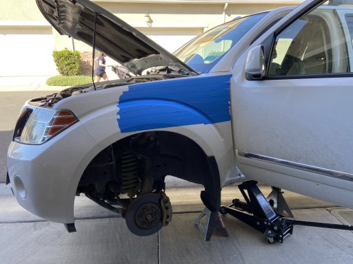

The first step with to replace the suspension and tires to get the ride height up to clear obstacles. This was where the "Global Platform" hit its first "only looks like a global platform" junction.
The US Pathfinder shares the same body and frame in the USA from its introduction in 2005 until 2007, where Nissan resigned the front end to make room for the VK56 V8 from the Titan and Armada. Only the 3.0L V6 Turbo Diesel models received this same frame extension and were built exclusively in Spain according to some information that I was able to find. They were exported from there.
The suspension, from frame rails, rear frame rails, roof rails/mounting points, and differentials are all different. Please be aware of this, but there are alternatives to get the same end result.
Ironman 4x4 was the first Australian company to manufacture US Spec suspension upgrades for the Pathfinder. I am aware the ARB/OME and Dobinsons will fit, but OME doesn't offer any warranty or even list the parts on the US Catalog. It's an alignment issue that, again, can be corrected for $27 with some camber bolts. I had no plans for a dedicated bullbar, perhaps a hidden winch mount, so the Ironman 4x4 Performance Lift fit the bill perfectly. They quote a 1.5" lift total but the initial lift was closer to 2.25" and netted only 1" of lift after 1 year of use. I recommend the "Constant load" version. They are the same spring rate but 10MM taller and should offset the progressive sag.

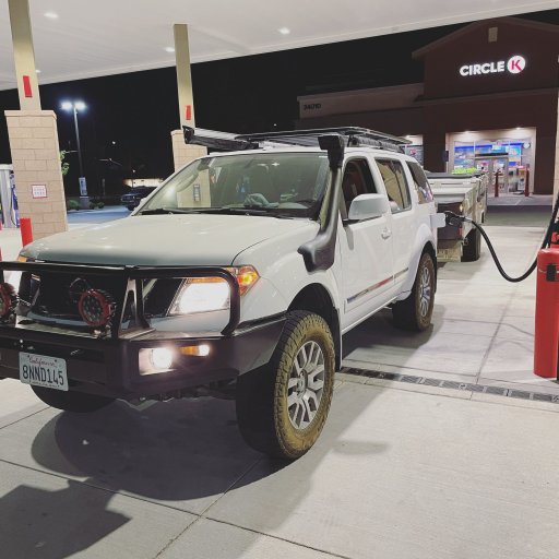

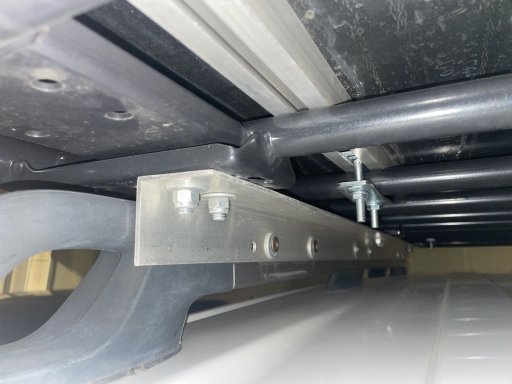

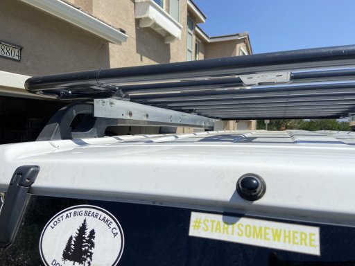

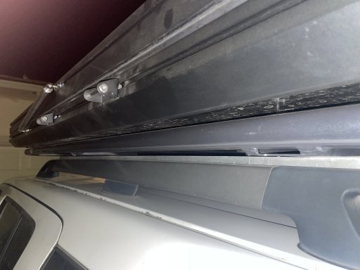

The roof rack department in the USA for the Pathfinder is another dismal area. In non-domestic market vehicles, they rarely came with the same roof rails the US market did, so plenty of options exist. The ones that were for my roof rails were removed due to manufacturing issues. I was able to pick up a 2nd hand New Out of Box ARB Flat Rack for a GX470. With some ingenuity and luck, I used 1/8" angled aluminum from Home Depot to fashion some brackets to mount to the already rated 220lb roof rails. Perfect match! The bonus was getting an 8'x8' awning for only $99 shipped to me with brackets!
At the same time was probably the most daunting of projects... The infamous snorkel! :: Insert Duh Duh Duh music here:: Drilling a small hole in your pride and joy is nerve-racking enough but 5 - 5/8" holes followed by a 4" hole is just plain nuts!! There was no coming back from this. The damage was one and I was randomly successful. I measured probably 10 or 11 different ways. Had the wife check it out (She covered her ass with an "it's probably off but looks okay from here").

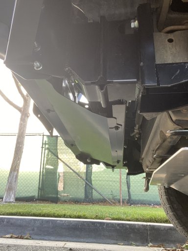

The skid plates or lack thereof kept me up at night. The thought of my entire vehicle's weight, resting on the transmission oil pan sent shivers down my spine. One of the biggest names in killer protection on an international level was ASFIR. I had their gear on my LR3 and it was bombproof. I ordered up the Aluminum Full Set. Front to back!!! Crap... That's right. I have the elongated Pathfinder front frame!!! So now I have the protection, minus a 4" gap where there seems to be a disconnect from the bumper to the Sump Guard. And I don't even have the V8. Insert insult to injury here.

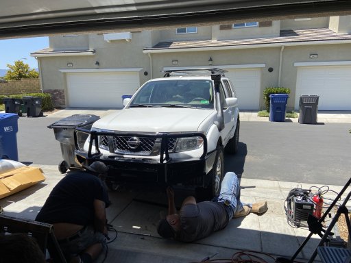

The front protection was actually a necessary purchase. As much as I love the look. I needed more weight and protection from Animal strikes (nearly took out Bambi and her 3 friends the trip prior with the trailer attached). Ironman 4x4 and ARB both carried a BullBar with a winch carrier. The Ironman salesperson denied my sale as they were having issues with the fitment. Honesty is the best policy so I thanked him for that and ordered the LAST ARB Bullbar in the US during COVID. Another 5-8 months if I hadn't snagged it. Lucky me, the bumper happened to be at the same distributor as the skid plates as well, so shipping costs were reduced as well.
The bumper installation was not for the faint of hearts. Normally, they would bolt up perfectly, with aligned holes and clear directions. The holes on the mounting brackets were 1/4" off from the frame horns. If I hadn't had my custom fabrication cousins helping me that happen to have a work van equipped with a Plasma Cutter, I'd be S.O.L. With those cuts we could mount the brackets and get the bumper loosely mounted and aligned as best as we could. There was a 1/8" discrepancy from left to right. Bumper mounted we were able to move onto the skid plates. The directions were a bit lacking but gave us enough direction to mount them correctly. For those with Nissan's and looking for the ARB bumper. You need to purchase LED Turn Signal bulbs for the truck. The BCM freaks out over the current and will not allow the signals to work correctly. Mine were $20 from AutoZone.
The added weight up front and protection under the truck changed the dynamics a bit. For the better actually. The front rode well and the added weight helped with bobbing while attached to the trailer. At this point, the front coils were over a year old and they were sagging pretty bad. I was nearly back to factory ride height with the extra weight. I rang up Ironman 4x4. They randomly suggested a Diesel Spec spring for the front. It was sprung higher and had an increase in height as well to help level the truck out.
All in all, the spring was added and it was... Jarring! Jesus H Christ! This was like attaching the wheels to the frame directly. To assist in the break-in process, I embarked on an 1100 mile journey from LA to Kanab, UT to Flagstaff, AZ, and then home. That did help greatly throughout. I think they just needed a bit of a beating to start feeling like a coil and not a 3rd world prison inter
