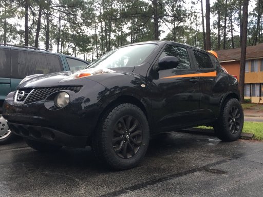

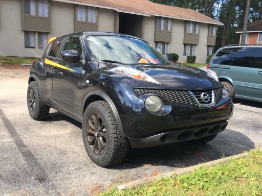

For me, purchasing my first car was a big deal, and I had almost no idea what I wanted just a couple of years ago. A sedan or a coupe would have been very easy to drive. A Jeep would have done it all, but I could get so much more vehicle for that kind of money. I absolutely love FJs and 4Runners, but I didn't want to jump straight into a big SUV. Looked around for a long time at AWD crossovers, the Subarus have an offroad pedigree, but I've almost come to expect people modifying them.
But there was one vehicle on the streets that would always catch my eye--
The rally stylistic cues, the fastback/hatchback silhouette, the accentuated, almost aggressive fender design...
If only it was wider... and taller...
I've had tons of crazy ideas for car mods,
But, to me, this one seemed to be cheap, straightforward, and pretty much a no-brainer.
That being said, I've only just begun, going about 40mm higher on suspension and moving up to 245/65R17s from the stock 215/55s. It rides and looks so good that I seriously don't understand why Nissan didn't just make the car this way from factory...

As far as I've seen, there is almost no offroad aftermarket parts specifically for the Juke. I've seen one heavily customized Juke out of Taiwan, but I could never get any info on it. There are a small handful of people in the US that claim to be "offroad" on the Juke forums, one used a coilover setup to get the lift, and another took theirs to a custom suspension shop (and basically got their front struts botched, there was a lot of drama)
I was lucky enough to stumble upon an Ebay seller from Russia called Tema4x4 who was selling 45mm polyurethane spring and strut spacers that claimed to fit the Juke, and I had gotten them installed professionally with no problems!
I think the stock axles can handle a bit more height than that, but going higher than 45mm is going to require a little fabrication and custom parts.
And of course, getting in touch with a good fabricator is going to be inevitable, but that's time and $$$ I don't have.

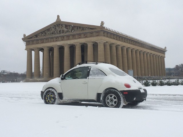

This is not my rig, but son of a b-, somebody out there beat me to it! New body VW bug on a Can AM chassis! This is EXACTLY what I had in mind in one of my earlier posts, but if I had my way, I would make it hard top convertible and keep the fender flares on.
