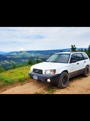

Considering the fact my last two vehicles were Subaru Forrester’s this is already miles and miles ahead of what I’ve been exploring with. A73EFCDA-2031-4643-B5AA-30B619D3BD14.jpeg9B3145E8-1944-48FF-8AA4-BA874F00D6AB.jpeg7E44A09F-670F-4A7A-B82E-373BF85BE52D.jpeg

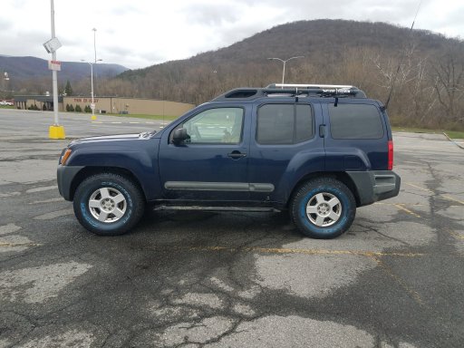

35s generally require a Titan swap, 2" body lift (because of front up travel) and fender trimming. There's no body mount trimming like Toyota but the melt mod is literally taking a heat gun and heating a small section of fender liner behind the front tires and pushing it back flush and 285s will fit at the OE ride height.
265/70/16 @ factory height
285/75/16 @ factory ride height
Only melt mod required.

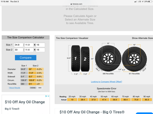

Here is my point on tires I jotted down a quick chart of a couple different tires and their actual diameters and weights if you look there’s quite a few 285/75 that are nearly as wide as some of the skinnier 315 /75 . 2F696277-2BD2-4E8F-B601-A07316B50C14.jpeg
So with a set of wheels with the right offset you can get that taller skinnier 315 to squeeze in where the 285 fits 8AE8B213-753A-4940-8B6E-119C7C650BF4.pngF284A188-C052-4053-AA86-C9F8EE3390D0.png
Like I said it will take some experimenting and trail and error and in the end I could be completely wrong but we will see in the future what’s possible

Here is my point on tires I jotted down a quick chart of a couple different tires and their actual diameters and weights if you look there’s quite a few 285/75 that are nearly as wide as some of the skinnier 315 /75 . View attachment 120475
So with a set of wheels with the right offset you can get that taller skinnier 315 to squeeze in where the 285 fits View attachment 120477View attachment 120476
That's a lot of research, and I totally dig that! You're right, tire sizes vary wildly by brand. There's no set standard on rim-size or tire pressure for measurements which obviously impacts width measurements a lot. With metric tires height is a function of width so that will vary a lot too. For tires measured in inches you'd think the height would be consistent, but it's not. I suppose that comes from the tire pressure it's measured at. If you want to put in the time and risk buying tires that don't work you could well find the "magic" tire that absolutely maximizes tire size to the last fraction of an inch. Otherwise, I'd learn from all the trial and error the community has already put in and run what is proven.

But I will use my little Subaru Forrester has a really good example. If you read anywhere online you will be told time And time again the only way that you can fit a 235/75r15 On one is some major trimming at least a 2 inch lift if not more and subframe spacers ect ect ect . With the right set of wheels no metal trimming , some fender flaring a little heating and hammering of the firewall And some remolding of the plastic fender liner I got them to fit with no rubbing even off-road ........ well as Offroad as you can get in a Subaru I swear I spent 50% of my time with two tires off the ground LOL . Sure it took a lot of time in the driveway bending a little metal re-mounting the tire , cycling the suspension but in the end they fit perfectly .
