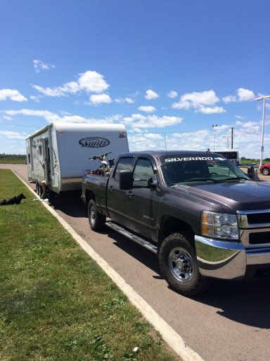

Here is my 2010 Chevy Silverado 2500HD. I have had her for 3 years now, I'm the second owner and we originally bought her to tow our Jayco 29' trailer (what my wife considers a camping requirement). This model is the LT which is pretty much a base model package. This means she is a clean slate. The engine is the 6.0L Vortec gas engine, it still has the stock power train and suspension with 3:73 gears.IMG_0082.JPG

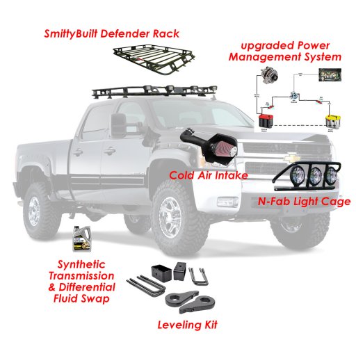

So far the truck has been able to take me where ever I've wanted to go but I do want to make some upgrades. Now because the truck is going to double as my overland rig and our tow rig I can't get too crazy but I have some rough plans laid out.
The first few things I have planned are mechanical, flush and swap the transmission, front & rear diffs and transfer case to synthetic fluid, add a cold air intake, and set up a dual battery power management system.
For the suspension, I'm not sure which way to go (this is where I'll need your advice). Most full sized trucks here in Canada go for some kind of "lift kit" which looks ok but I'm not sure how functional they are. I really like how the Icon Vehicle Dynamics systems work but I have only ever seen them on the mid sized trucks. And remember I still need to be able to tow a 10,000 lbs trailer....

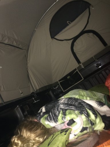

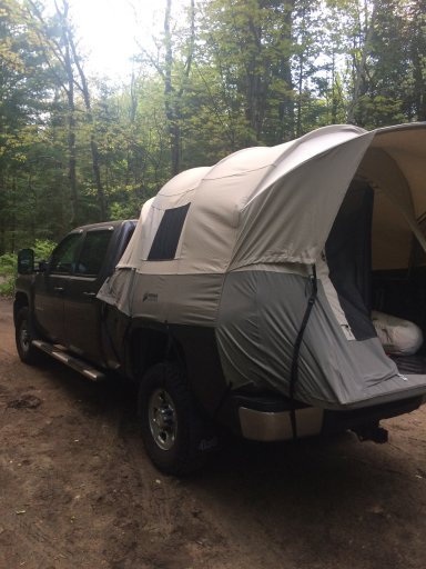

Little update, While the mechanical's and maintenance are under way I did not want to let the season get past me so I snagged a Kodiak Canvas truck bed tent and this will be my main set up for sleeping.
This tent provides an amazing amount of livable space in the back of the truck for under $300. For now we are just using sleeping pads but we do plan to get one of the air mattresses for back here when my wife tags along. When I'm headed out solo I'm thinking a cot will be perfect.
As you can see there is so much space back here.
