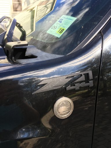

image.jpeg I'm home for one week before I have to head back to work. The flood waters didn't get in the cab, just a little over halfway up the wheels, Lucky me! I have a lot of installs to do, but for now I'm having the great debate on where to put these?!
Reactions: Steve

Looks good. I haven't put mine on yet. I was thing of putting them on top of the 2500HD. The fender looks good too.
Yeah I de-badged mine a while back, so it would look kinda funny by itself there! But it would definitely look good there. Nice truck by the way, there aren't too many people with full size pick-ups on this forum
