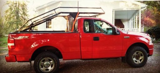

Is it 4wd? are you going to level it out? If the answer to those questions is NO... then you could maybe squeeze 33" tires (depending on width and wheel backspacing) with some slight trimming and rubbing....

No way 35” tires will work with a level kit and stock wheels, you need a lot of trimming and wheels with way different back spacing. With that increase in tire size you may consider rehearing as well.

I know there is a 3" leveling kit out there, but I've never heard anyone recommend it on these trucks after years on the Ford forums. The 2" and 2.5" kits are what people usually go with to fit a 33' inch tire. Personally, I went with the Rancho coilovers, which lifted the front end 2.5". This allows me to run a 275/75r16 BFG AT with no rubbing issues at all.
