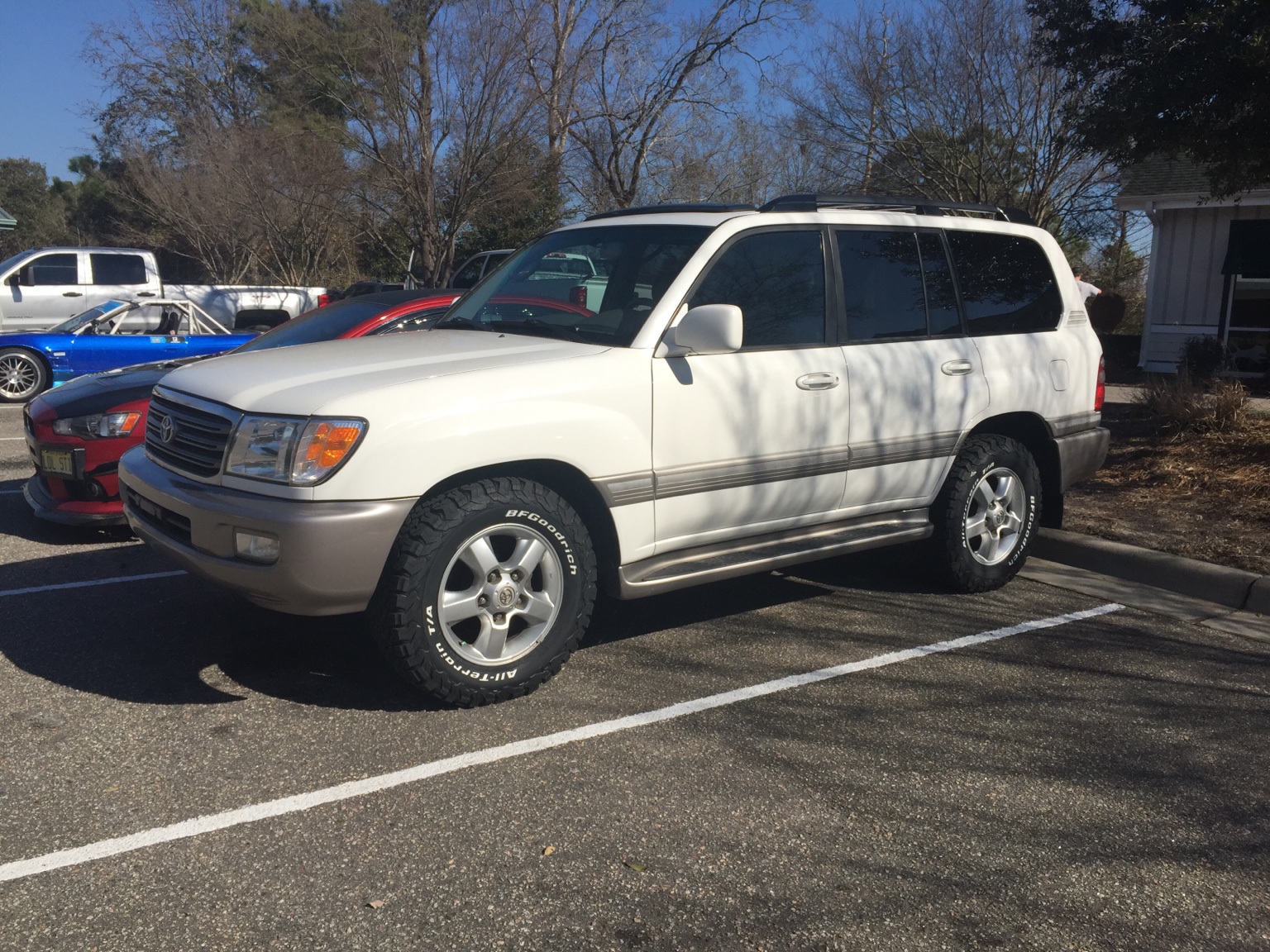

I put BFG KO2s on today to get rid of the pedestrian street rubber and it’s starting to look much better already.

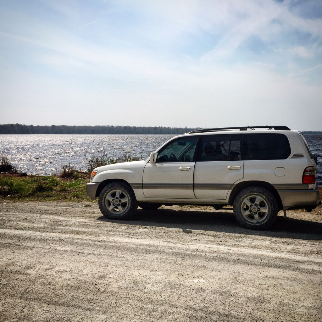

We took our maiden voyage Sunday on Fort Fisher Beach here in North Carolina. Glad to say I know for sure the center diff lock and four wheel drive work great!
Took a few minutes to air down the tires, decided on 25psi. I could have gone lower but wanted to see how it felt at different levels. I went through the worst parts a full 36psi, I needed to find our limits. Honestly the truck was fine and I never feared digging in. Ultimately the air down was about experience and making it easier on the truck getting through the sand. More over and less through.
We had a blast and I will absolutely go again. I have a small squeak in the front, sounds like the serpentine system. I have a gates belt, tensioner and idler kit ordered already. Next on the to do list including the belt and idlers is flushing the fluids, stainless brake lines, fix the rear hatch lock motor and put the new bottom seat skin on the driver seat.

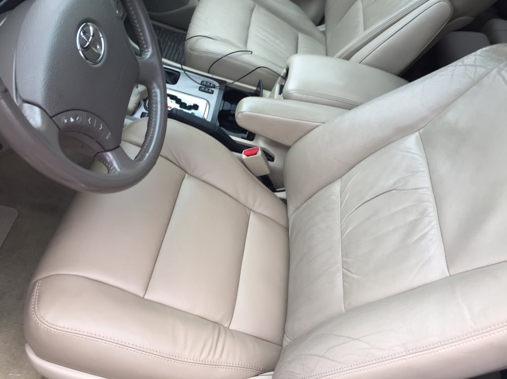

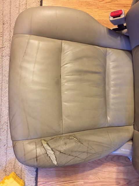

Where did you find the seat skins? Mine are shoot and I have been looking into repairs, seat replacement, etc. New skins never occurred to me, but is a brilliant solution.
https://rover.ebay.com/rover/0/0/0?mpre=https://www.ebay.com/ulk/itm/282618079440
I found them on eBay. Good reviews and they look much nicer than sure me of the other ones I found through google. It’s here and it looks really nice, but I haven’t installed it yet to be able to account for fit.

Got the new skin installed. I couldn’t be happier. The quality is awesome and it fits really well. Can’t wait to put the seat back in tomorrow.

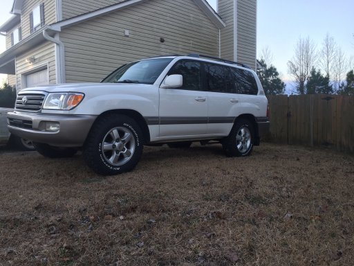

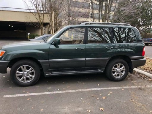

Nce ride! Liking forward to watching your build as we just picked up a 98 Lx470 ourselves. What size Ko2s did you go with? View attachment 48250
Sent from my SM-G930R7 using OB Talk mobile app
I went with 275/65/R18 it's 1 inch overall taller, meaning half and inch increase in ride height and minimal speedometer variance. 60mph on speedo is 56-57 actual speed. They have been great so far.
