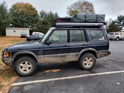

F9A6D7C0-9DAC-4C67-9C45-0850F937D0CE.jpeg CC6372C6-ED57-4FC4-A213-5F60170CA2FB.jpeg 55181A85-5F6E-4592-9826-0DBA258100A0.jpeg Hey folks, just joined the community and am looking forward to contributing in any way I can!
I bought my Disco about three months ago, it was bone stock with a Voyager roof rack. Pictures will sort of explain the evolution as the thread goes on

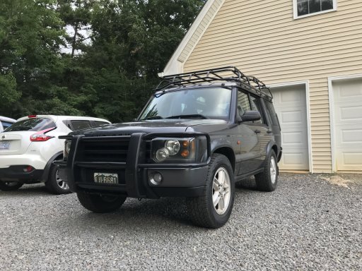

Nice looking disco! I too have recently acquired at disco 2 (2003) which I am hard at work on already. I have a long list of things to do to it, but I am currently investigating an engine tap. Hoping for valve line issues as opposed to cylinder problems.View attachment 76298View attachment 76299
Mine taps too, they all have funky noises. Mine is a lifter, but since yours is a 2003 I would investigate your oil pump as they have a rather troubling tendency to fail on those engines due to a defect in the block casting. I have fixed several, you just need to remove the lower alignment dowel on the front of the block before reinstalling the timing cover.

Noted, thank you! I will add that to the list of parts to replace. I do love wrenching on this vehicle, though.

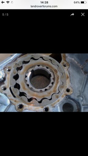

No problem! I work on these all the time so if you have any questions just shoot me a message. I would highly suggest replacing the timing cover/oil pump unit as one, the screws don’t always want to come out of the pump. But I’ll include a picture of the oil pump out of an 03 similar to the one I did last month IMG_7106.JPG

No problem! I work on these all the time so if you have any questions just shoot me a message. I would highly suggest replacing the timing cover/oil pump unit as one, the screws don’t always want to come out of the pump. But I’ll include a picture of the oil pump out of an 03 similar to the one I did last month View attachment 76405
Are those cracks in the outer rotor of that oil pump? ..yikes!

That is correct, 2003 4.6 engines and some 2004 4.6’s have a misaligned alignment dowel for the timing cover that causes stress on the planetary gears and causes them to fail as pictured.
Well considering I don’t make that much, it’s gonna be as cheaply as possible while retaining high quality hahaha. So far mods are, Voyager Rack, OEM Great Divide Range Rover aluminum bullbar/bumper, Hella 550 driving lights, 32” tires, Hi Lift, Sand Ladders, and Shuttle Valve Switch bypass (ABS fix).
Planned mods are as follows.
Bilstein Shocks and HD springs, OEM 16” steel wheels and KM2 tires, bash plates front and rear, Hella 1000 flood and spot beams on top, Dixon Bates recovery jaws front and rear, some sort of better rear bumper, rear locker, etc. the list will continue to grow!
