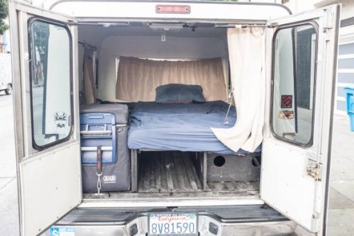

Upgrades when purchased:
Six Pac aluminum contractor shell - Modified with RV vent/fan, side windows, and foam insulation
National Luna Portable Batter System
ARB Fridge
Raised Bed Platform with storage compartments

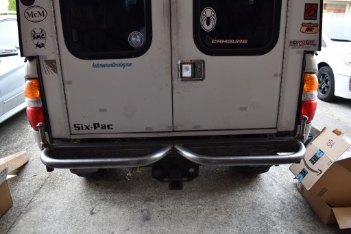

ADS_0001.JPG ADS_0002.JPG ADS_0006.JPG ADS_0007.JPG ADS_0008.JPG ADS_0010.JPG I started building a rear bumper and tire carrier, here is my day 1 progress. Design is a dual swing out, the drivers side will hold fuel cans and the passenger side will be the spare tire and fold down table. I purchased some 2x3x0.120 and 1.75 x 0.120 tubing and some 1/8" plate for the table and fill in areas on the bumper.
For tools I'm using a Lincoln Mig gun, JD Squared Bender, and a trusty old air compressor.

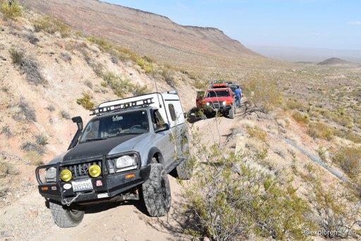

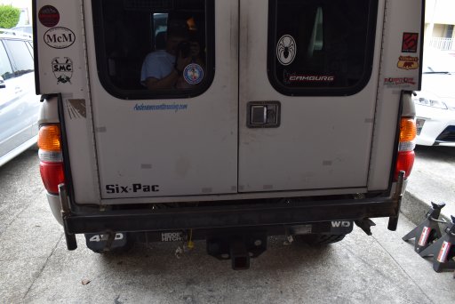

I finished the bumper, got a spare tire mounted at America's Tire, installed my radios, roof rack, lights, and rewired the aft end of the truck just in time before leaving for San Diego and going onto Laughlin for the Mojave Road Trip. I never had a chance to test anything or time to make any changes before getting on the trail, the best part is nothing broke and everything worked!
Photo Oct 16, 16 53 57.jpg [/ATTACH] Photo Oct 16, 15 09 11.jpg Photo Oct 16, 16 55 38.jpg Photo Oct 16, 16 47 12.jpg Photo Oct 16, 16 55 07.jpg Photo Oct 20, 14 50 53.jpg Photo Oct 20, 14 49 54.jpg

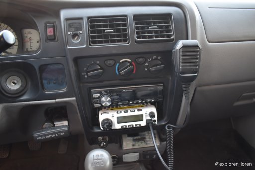

I have a 20L Nato Can, 11lb aluminum propane tank w/ power tank mount, 285/75/16 spare, and a flip down table on dual swing outs with a single lock pin. The roof rack is a Smitty Built Defender rack it is the smallest one made for the a Yamaha Rino, I then installed a Rugged Radio RM60 under the radio and an old cb behind the center console. The chase light is a Rigid multi light that took place of the broken 3rd brake light which also doubles as a cargo light.
