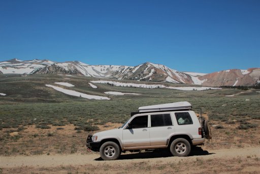

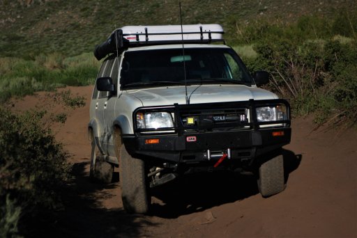

Here are pics of the truck raised up a full 2 inches.
And here it is on a shakedown run in the Granite Dells in Prescott. I ran Broken Arrow in Sedona with the old trooper once before it broke and was impressed with how well it did bone stock. Can't wait to run that again in this thing.

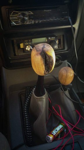

In the works is an in-dash install of the CB, a DIY full-length slim profile roof rack out of an old rack I had laying around, and a sleeping platform/storage build for the back. All of those in time for me to drive it up and volunteer at Overland Expo West. I will post more pics of those builds as they happen.

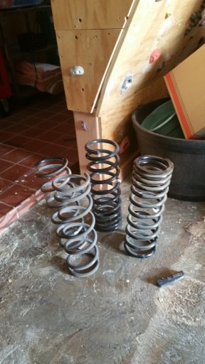

I forgot to include the pic of the old springs next to the new ones (which spent some time under the 2001) No surprise the new ones improve the ride a whole bunch! The old ones were downright squishy.

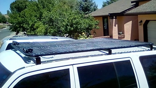

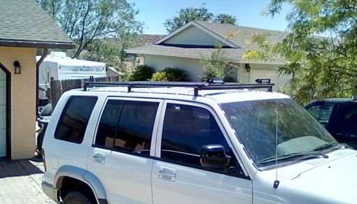

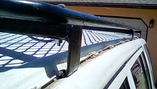

finished this a few days ago. I am not a big fan of roof racks, but I plan on getting a plano gun case and some max trax to put up there permanently. Also it is a handy place to mount lights. I cut up an old cheapo rack I had laying around and welded it back together to make the rectangle of round tube. The rest can from the steel yard. All in it cost less than $150 but took probably a solid 40 hours of work. That time was mostly because I have virtually no welding experience and did a LOT of grinding down bugger welds...
The original idea for the cross bars came from this site. http://buckwheat-anderson.com/bcanderson/trooper/Roofrack/Roofrack.html

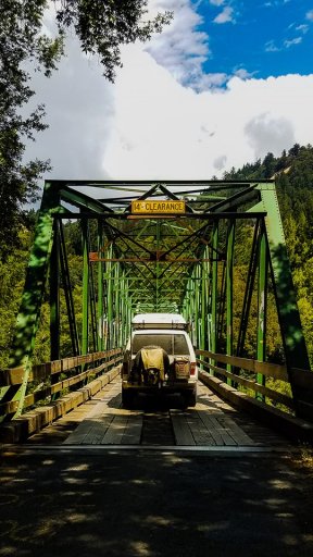

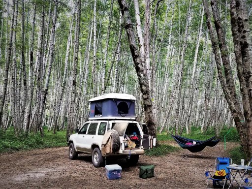

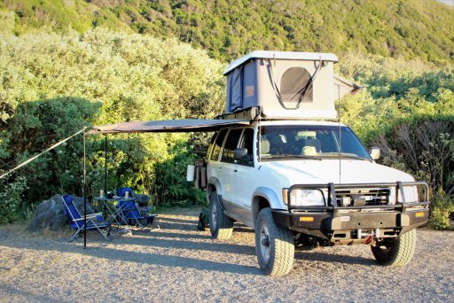

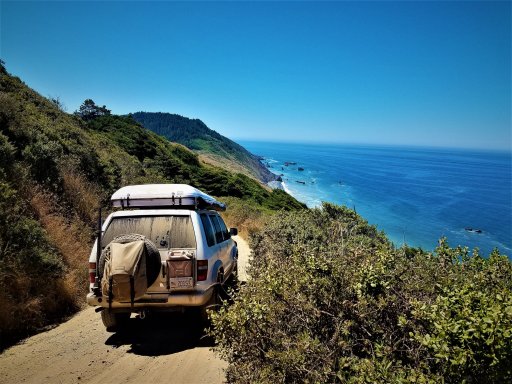

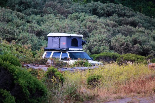

A few months ago, I updated the build quite a bit, then did a trip to Humboldt County and the Lost Coast. I got the Roofnest for $2100 off of CL. It was brand new and still was in the factory packaging. The guy bought it but never mounted it. There are a few quirks about the tent I don't like but overall, I am very happy with it.
I am also very happy with the Bat Wing. 15 or so deployments including 24 hours of rain and it is holding up nicely.
Still, a lot to do to this rig, but this is a big start!!!
So here are some pics from that trip.
65672550_10157176089062976_267862202420035584_n (1).jpg20190626_205855.jpg66398627_10157212304727976_804817527707271168_o.jpg66594820_10157208216112976_5543447429191303168_o.jpg66751641_10157212381132976_2232919901956210688_o.jpg66789647_10157212381897976_8975091140093018112_o.jpg67224304_10157212305262976_7052674253828653056_o.jpg

I see you've got a gas can attached to the little back door. How did you mount that? I'd be interested in doing the same thing to my '98 Trooper.
I just drilled right through the sheet-metal and put huge washers to prevent it from pulling out. 4 on top and 2 on the bottom. Could have just done 2 on top.
