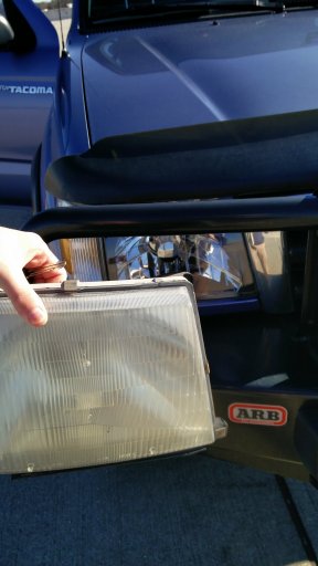

After 17 years of weather abuse, my headlights had started getting pretty dull, and seeing at night became pretty difficult. While I was searching for replacements I had planned to keep an OEM look to them as I was not a fan of many of the aftermarket headlights. Once I found these though, it was a done deal. It updated the truck's front end look to be reminiscent of the LC's not found in the US market. They were a quick install, with the most difficult part being adjusting them so I don't blind people as I'm driving down the road.
