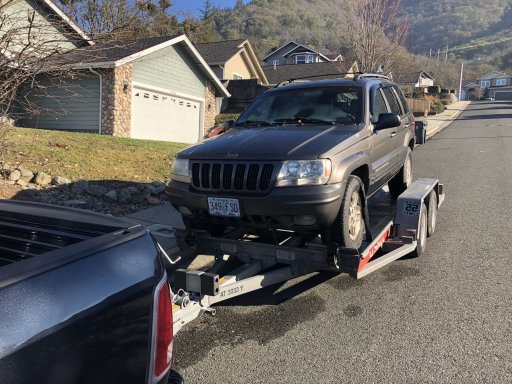

Saving it from being abused and towing her home
After hours of scrubbing and spit shine, looking like it supposed to
2.5” front 2” rear and Rubicon take offs and minor trimming
