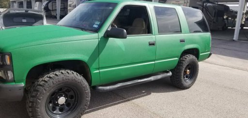

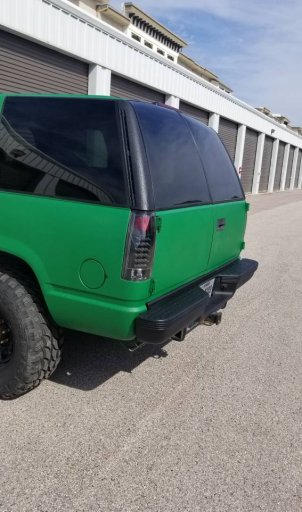

I like it , sprayed of pretty nice and even. I did it at 80psi. Thats a little higher then they say but its not as bulky texture which I was going for and about 18 in away. The prep took a bit but I did alot of prep like replaced hinges and door rollers so doors came all the way off.

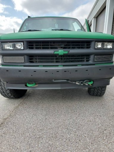

Yes I do and I love it went on very even. Getting hidden winch and rock sliders put on this coming week... Also does anyone know of a texas group or Houston group or club to join?

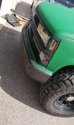

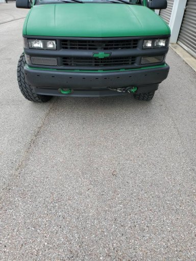

Thank you all , and yes I bought a universal winch mount but you will have to modify it depending if you have an auxiliary trans cooler from factory like mine cause the lines run under the condenser. I actually had to cut the plate it and drop it in between frame rails and used the sides that I cut off and had them welded in for support. If you dont have the auxiliary trans cooler you should be able to mount it on top of frame rails. If you do that then your hole for the winch cable will be about the middle of your bumper. Let me know if I can help anymore. Also I did get the 12,000 lb smity built winch with WIRELESS remote the xr20 serious I believe so it's also waterproof.

Do you have any pics on how you mounted the winch behind the bumper? i am wanting to do something similar with my 99 as i dont like the look of the aftermarket winch bumpers and i have a nice solid chrome bumper with no trim holes. Love the look with the green raptor liner
