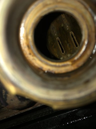

For Labor Day Weekend, I drove up to Bishop, CA, with a ton of overheating issues. After leaving the following morning, I took a look at the radiator. It was in horrible shape, completely rusted out.
I added some Thermocure as per recommended by a Montero Facebook group. It made a HUGE difference.File_000.jpeg
