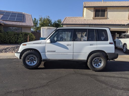

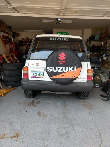

Two weeks ago I picked up this sweet little Zuki from my neighbor down the street. I'd had my eye on it for a while so once I saw the opportunity I jumped. Big plans for this little 1.6L monster.

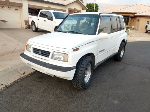

First things first, new wheels and tires! Found some CJ5 wheels with a good backspacing on offerup for cheap so I grabbed them real quick, and of course with wheels sitting in my garage I needed tires obviously. Queue 4 235/75r15 Forceum MTs to my door. Minor rubbing in the front at full lock or if there's enough flex from a curb at the mall. Thankfully the lift kit is on the way.
Oh, and grabbed a new tire cover for the spare.

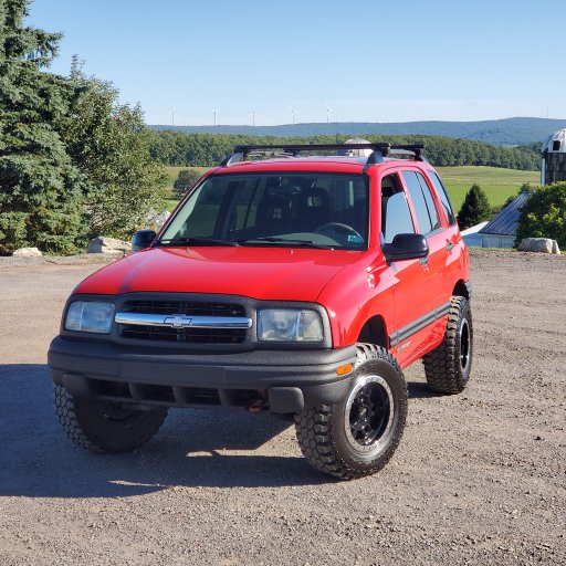

Clean 1st gen! I have a 2nd gen that I've been playing with for a few years now. Wouldn't trade it for anything. My build thread is here... 2003 Tracker build
I read where you want to replace the half shafts. See post #10 in my build thread. All aftermarket axle shafts are crap, and not even close to oem design/quality. If you stay stock, you may be able to get by with them, but if you do a lift, the aftermarket half shafts won't work out for you. They can't flex, so they'll just break. Your options are either re-boot the originals, or find some half shafts at a salvage yard with the boots still intact.
Also, if you haven't already discovered it, there is a facebook group called "GEO/Tracker and Suzuki Samurai/Sidekick Owners Club". There's over 17k members on there and lots of good info.
Looks good man! Thanks for the info too. I was planning on just replacing the boots but I didn't realize that after market half-shafts were not up to snuff.

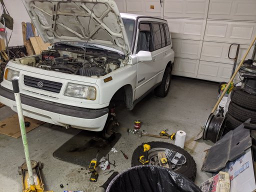

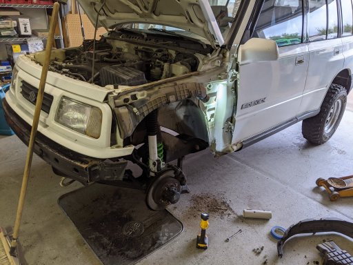

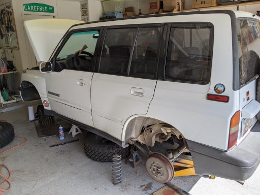

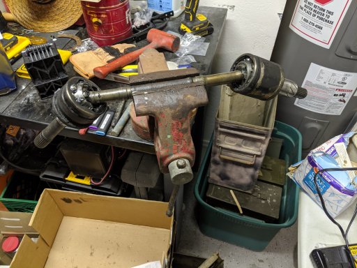

Haven't given an update in a while, things have been slow going (just like the 1.6L in this :tongueclosed:). The lift kit from Low Range Offroad has been pushed back to at least Oct 30 due to backordered parts so I'm looking for small jobs to do. All four CV boots have been replaced, the suspension has been ripped out in preparation for the lift. Shocks and struts were all shot, probably needed to be replaced in 2000 or so, haha. While she's sitting I'll get the new locker in I ordered. Might as well, right?

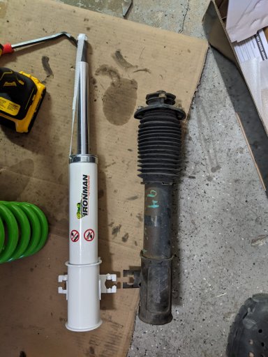

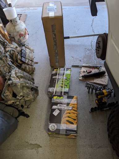

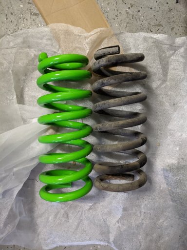

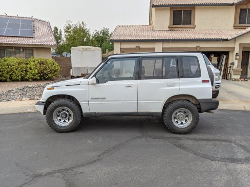

It's FINALLY together and on the road . The kit from LRO didn't have the parts available anytime soon so I ended up canceling the order. Thankfully, the kit I originally wanted came back in stock and was 20% off for a month long Black Friday sale. Best part? It was at my door in a week. Thanks Ironman 4x4. That victory was short lived when I realized I needed new strut mounts and boots, but hey Prime shipping is a thing.
Next up is coms equipment, snorkel, and locker (finally maybe) but plenty of fun to be had in the mean time.

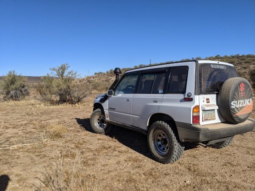

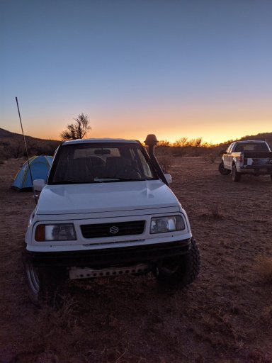

Quick update. Got the snorkel installed today! Despite having a template that was out of spec, the install went quite smooth; smoother than my Frontier and that had a template that was spot on. I guess it's time to take her for a dip and see what happens! Don't mind the bumper, that's a work in progress.

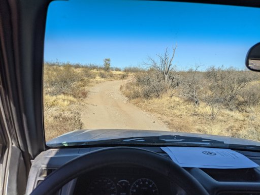

Maiden voyage! This is the first time on dirt since I've had this little rig so nothing too difficuly (read: easy), just enough to stretch her legs and get a feel for how everything behaves off pavement. No 4x4 necessary this time around, which is fine since I was out with my buddy in his 2010 F150 FX2. While going through the ruts and washes of the desert, everything felt great and now I can't wait to get out somewhere more technical.

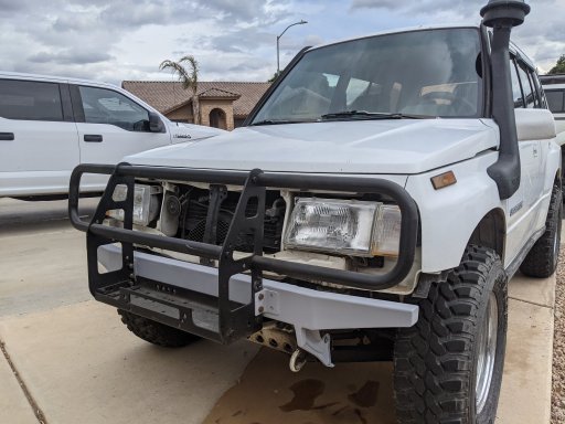

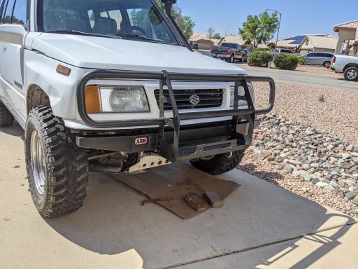

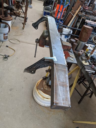

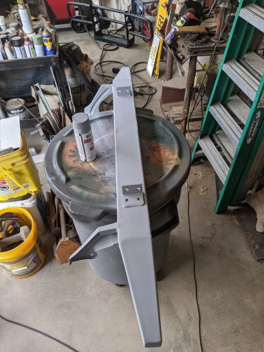

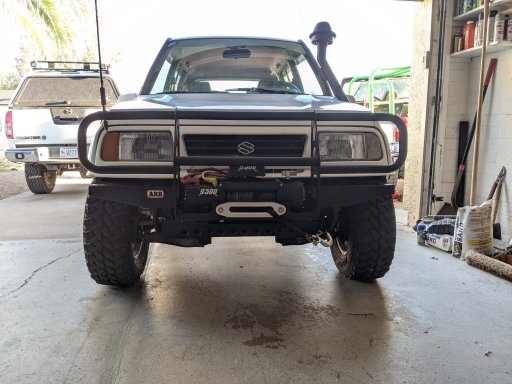

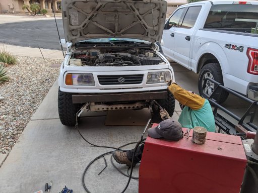

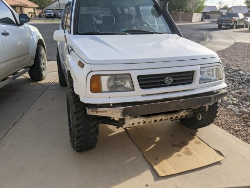

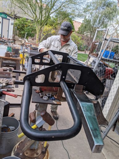

Been busy since the Holidays, but there has been progress! My buddy @Forte brought me a winch carrier for a small truck/ SUV from Nebraska when he moved back to Arizona. It was the perfect size for this little vic so incorporating it into the build was a must. After some material gathering and bribing my dad with some beer (he's the welder) the Zook has a new bumper/ winch carrier!

Nice "ARB" you got there... ;) glad you finally got everything installed it looks great!
  • Love
Reactions: bawesomfels
Snorkel - check. Winch bumper - check. Throw some lights on there and you're good to go. Also, did you really put a 9500lb winch on a vehicle that has a GROSS weight of 3300lbs? Just enough power to rip the car in half. Looks like a beast.
Oh absolutely! I found it for a good deal and it made it so I didn't have to modify the carrier too much further for a smaller winch (most on the weight range I need are for quads lol)
