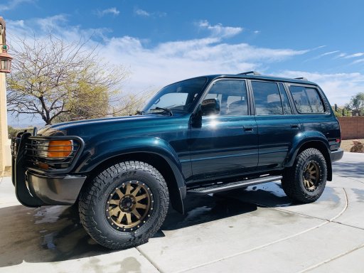

I wanted to start a build thread documenting all I will be doing to my HJ61 Land Cruiser. I started with a 2018 ORP 4runner, Land Cruiser 80, and now my latest interest... 1986 HJ61 Turbo Diesel Land Cruiser.
2018 ORP 4runner
1994 Land Cruiser 80 3xLocked

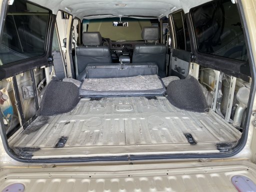

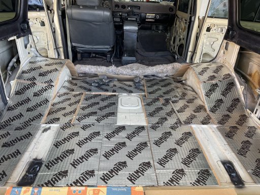

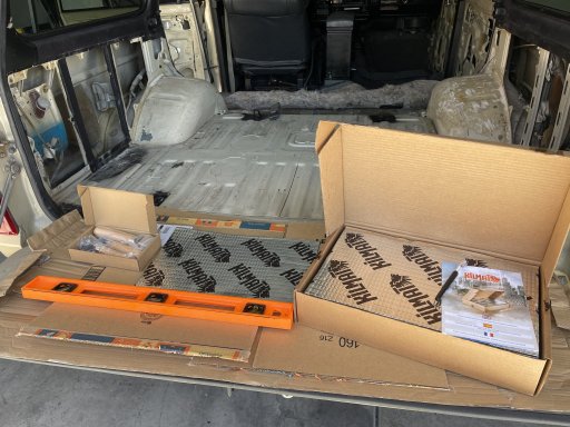

- Added Kilmat sound deadening to the interior floor from the under the driver seat to the rear trunk & all four doors. Spent about $150 in sound deadening material. Probably could have gotten away with $100 bucks of material, but once you get going you just start applying it everywhere. This took a better part of 2.5 days to remove the interior and install & making sure not to cover up any holes you shouldn't. Not something I really enjoyed, but I'm really happy if it reduces the road noise down any better than stock. So incredibly noisy inside the cabin compared to my 4runner and 80 series when on the highway. This install really helped me with learning a bit more about the interior, cleaned up the cabin, sprayed PB Blaster/oiled up on some needed areas, etc. It was well worth the time IMO.

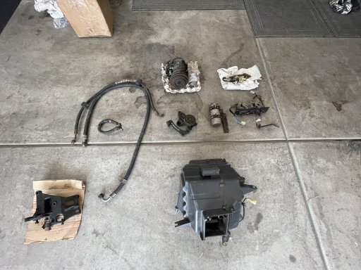

- Received most of the stock AC parts to install a full OEM AC system. Missing one bracket and condenser. Should have those next week. The car didn't have AC from Toyota when purchased by the original owner in Germany. Very rare I guess, but not something I can live without in Vegas.

Throttle cable sucked!
Kilmat everywhere. Makes a huge difference in the interior noise level!

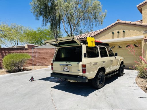

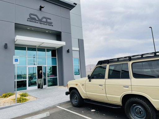

- Added CVT 94" awning from the guys at CVT Vegas.
- Also picked up a set of Maxtrax recovery boards and a Rotopax 2.5 gallon tank with mounting hardware.
Some driveway pics because the kids need some shade haha...

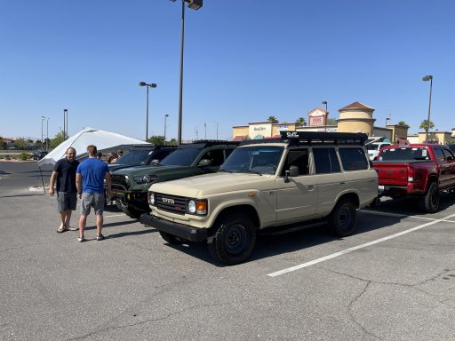

- Finally got the car registration done in NV. This was a pain, but finally got done after going to three different DMVs. Biggest issues was trying to find two VIN stamps. I had to scrap off some paint off the frame and then had to go to another DMV for an engine inspection. All done and license plate arrived...
- Went to first my meet in Vegas with the Battle Born Toyota crew. Glad I went, met a lot of very inviting people. New to Vegas, so it was cool for sure.
- Got all the parts together to add OEM AC to the ride. Geez, it's been killing me out here in Vegas without AC... haha. Hopefully there are little hiccups with the install. I know there's something or custom fab that will need to be done to make it work like 'stock'...

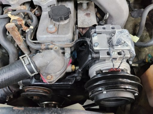

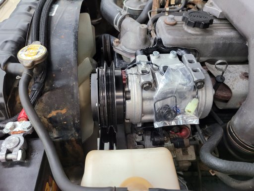

Been without the truck for just over two weeks. AC lines needed to overhauled by a local AC shop and some random nuts, bolts, belts, pulley, etc needed to be ordered as well. I'm hoping to have this back this coming week or next. Progress pics...
- Vintage AC condenser and new Denso AC mounted. I bought a used AC with most of the parts and the shop installing it said the damn AC compressor was seized . So I found a new AC on Amazon lol for $300 bucks. So freaking happy to have found a replacement. AC needs to be converted to r134 anyway from r12... so the old one probably wouldn't have lasted as long anyways. Just glad it bolted up with the stock adapter. Supposedly finding the adapted is the hardest thing. The previous owner helped me source all the 'hard to find' parts.

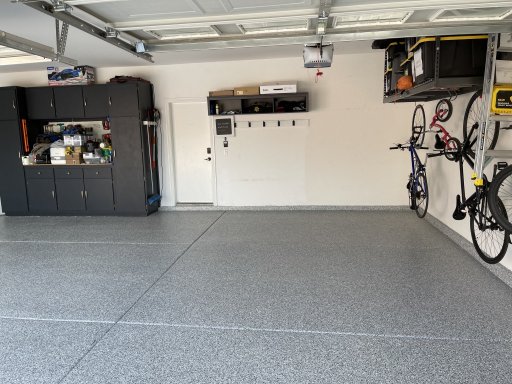

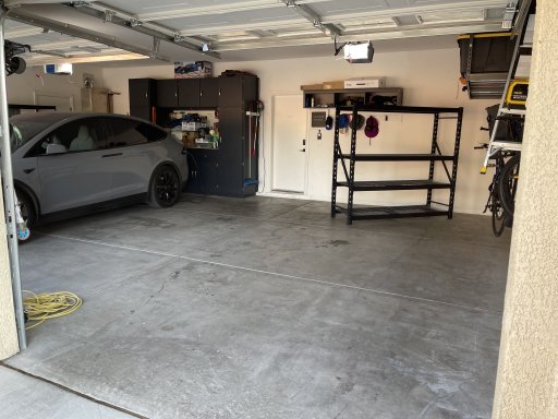

Side note, since the truck hasn't been around. I finally got my garage floors done with Polyurea as opposed to epoxy. So happy with it! I digress...
