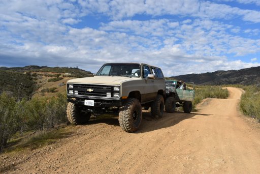

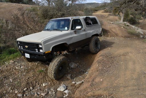

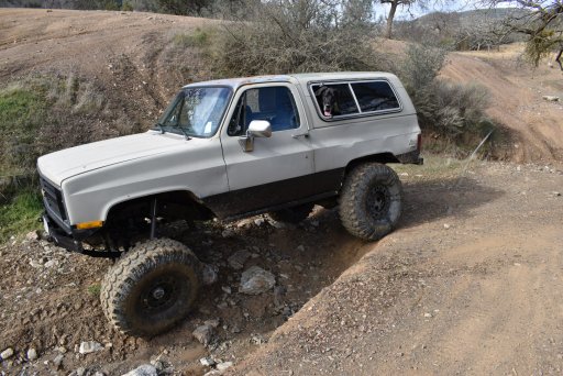

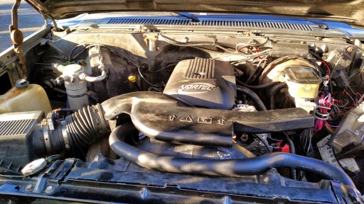

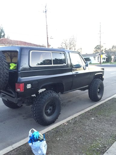

So I sold my epic rig and trailer to move onto a new project. Gone is the Toyota ( will always be a Toyota guy) and here is the Blazer.
It's a 1985 chevy blazer with a few upgrades and many more to come.
-1990 TBI 350 swap
-offroad design DOM engine cradle and mounts
-700r trans with shift kit, billet input and output shafts.

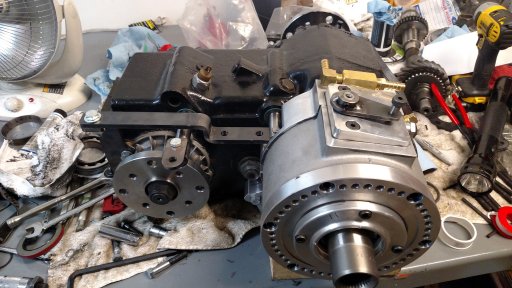

-dual cases, 203 to a 205 with hardened oversized input/output shafts. Allows 4:1 low range
-triple sticked, so front and rear are independently selectable for low or high range
-oversize DOM chromoly drive shafts by High Angle Driveline and spicer ujoints
-Military spec (3/8" thick axle tubes)Dana 60 front with Detroit locker and 4:56 gears
-14 bolt full float rear axle. Military spec as well. With Detroit locker and matching gears
-Off Road Designs high steer kit with heavy duty 2wheel drive steering box.
-Redneck Ram stage 3 hydraulic assist steering kit
-custom deaver spring packs up front
-rear shackle flip kit by ORD
-4 wheel disk brakes
-5 military H1 headlock wheels re entered by Stockton wheel
-40x13x16.5 irok super swamped tires
That's it's bones!!!
She is a little rough but I will clean her up real good :)

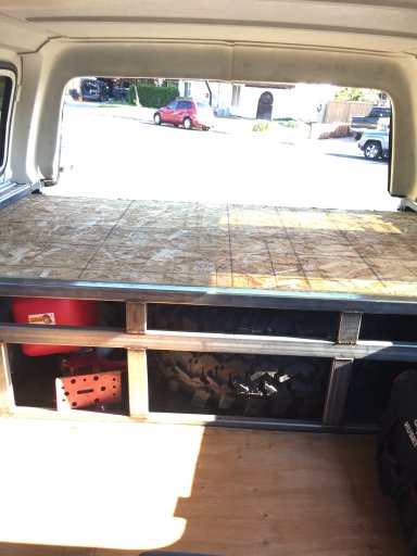

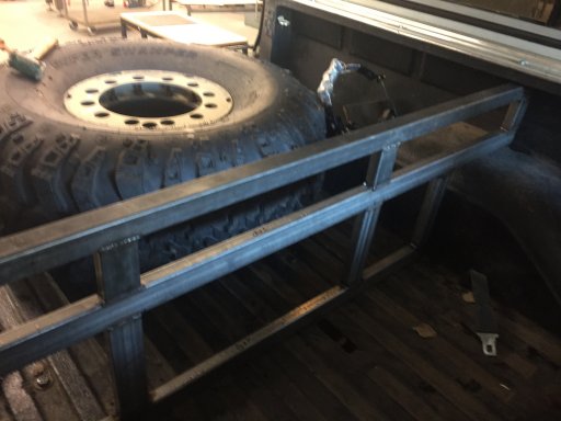

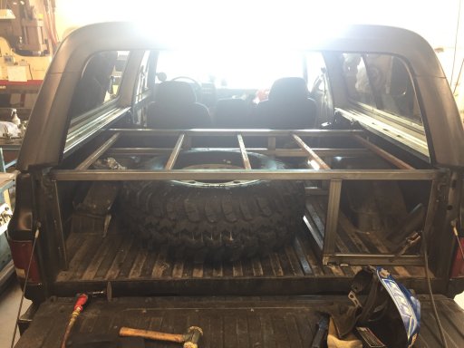

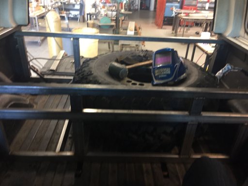

IMG_1694.JPGDidn't like my spare tire on the bumper blocking the little bit of non blind spot I had. I decided to move it inside and secure it. I'm building a platform over it and adding a some small compartments to store other gear as well.
