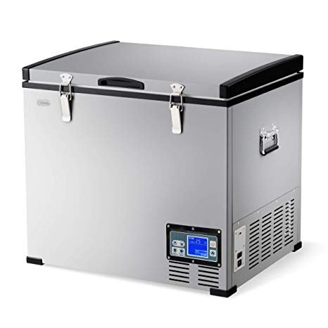

So we picked up the Costway 63QT fridge and fell in love with it from the moment I unpacked it. We ran it for a total of about 30hrs in the back of the truck hooked to a secondary truck battery that is not wired to the charging system of the truck. started the day at 13.2 volts and the fridge was set at "medium" battery saving mode. After about 30hrs of running it had drained my battery to the point that the fridge hit the limit for "safe" (11.7 volts)battery voltage. My question is.......does everyone run some sort of charging system for fridges and if so is anyone doing a solar setup? It was hot also.......80 to 90 deg for most of the two days

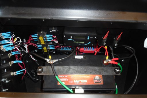

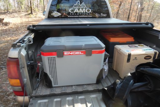

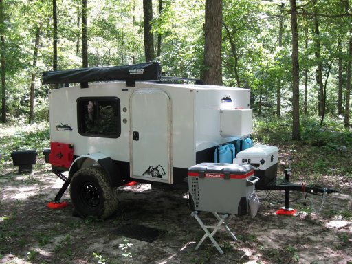

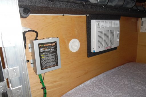

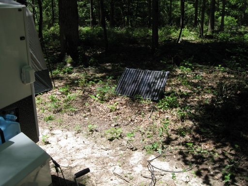

This works for me, when in travel I have my 40qt. Engel in the back of the bed of my GMC. I have a separate fused 12v. outlet socket wired in the truck bed. It runs off my main cranking battery which is XS Power AGM. In camp it's plugged into my trailer which is a VMax 125ah AGM. At camp whether on sunny days I have my solar system producing power, over cast\cloudy days or camping under heavy tree foliage I have my trailer plugged into a 2000w inverter generator which charges my battery when needed. For shore power or generator my battery is charged by a 3 stage Powermax 55amp Converter Charger a\c to d\c.

View attachment 106279View attachment 106280View attachment 106281View attachment 106282View attachment 106283
That is one impressive install!
