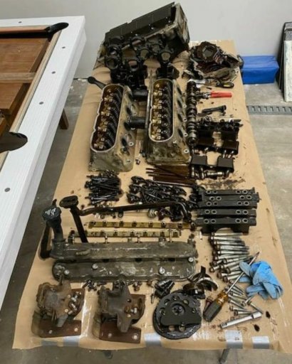

Completely rebuilt 5.3 LS (currently in progress)
forged rods / pistons
ported heads, upgraded valve springs and pushrods
arp studs on everything
possible turbo setup (ill find out whether or not that fits into the budget)
the current motor runs great but we pulled this motor from an 04 Silverado to start a new build, this is my son starting the tear down, learning part by part
scrubbing up each and every part, allows him to get his hands and eyes on them

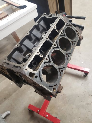

tore down to the block, crankshaft and rods were toast on this motor
although the crank shaft and rods were garbage after cleaning, I had the block inspected by a machinist buddy and everything was within tolerance

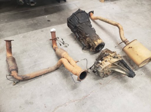

NP461HD Transfer Case
Upgraded custom carolina driveline Driveshafts

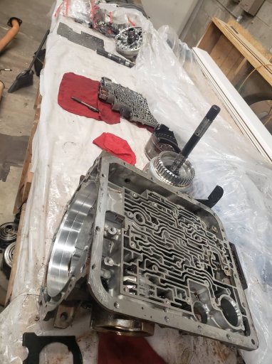

the transmission on the 00 silverado actually went out, lost reverse and 2nd. Being a GM mechanic, I knew the sunshell had gone bad, pulled the trans and ordered a Monster Mega kit, upgraded to 5 pinion planetary gears as well as a couple other gears that had lost teeth
this is the 4l60e pulled apart and cleaned up a little, everything is in its little bags, waiting to be put back together

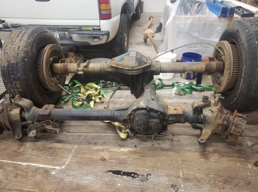

Axles (currently in progress)
HP Dana 60 front axle
- ARB Air Locker
- Chromoly axle Shafts
14 bolt GM full float
- ARB air locker
- Chromoly axle shafts
- disc brake conversion
I just picked up the axles this past weekend, havent unloaded them off the trailer yet. the tear down starts this weekend and then having them sand blasted
